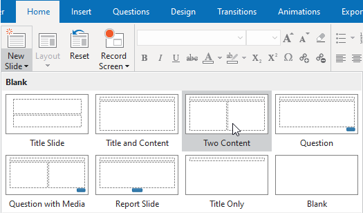

Using Preset Slide Layout
When opening a new responsive project, you will notice that the slide has its own flex layout by default. But you can also consider using other preset slides by going to the Home or the Insert tab, and then clicking the down arrow on the New Slide button to choose the slide layout you want. For example, I will add the Two Content slide.
As you can see, this slide contains perfectly arranged flex containers with their placeholders where you can add any content you want. I’m going to add text and an image to the placeholder on the left, and then continue to add an image below it by clicking Flex Box_5. After that, I click the plus icon and select Objects, then choose Image.

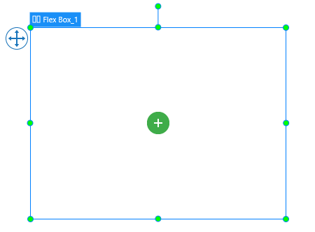

Inserting Flex Box
To insert a flex box to your project, in the Home or Insert tab, click the Container button and then click Flex Box. After that, a flex box will appear on the canvas like this:

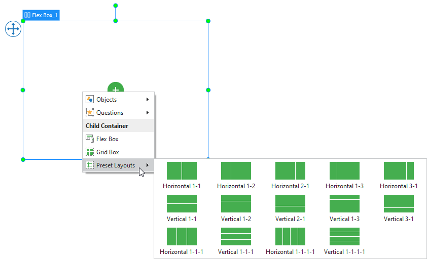

Adding Child Container

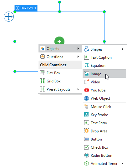

You can further add a child container to a flex box by clicking the plus button, then select 1 out of the 3 options in the Child Container drop-down list.
Adding Objects or Questions
Apart from child container, you can also add objects or questions to flex box as follows: you simply click the plus button in the middle of the box, then select either Objects or Questions and choose the one that you need.

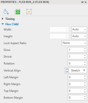

A flex child can adjust itself to fit the container. The Properties pane is where you find all the tools to customize the flex child. To access it, you simply select a flex child, then navigate to the pane on the right side of the working window. In the Properties pane, Size and Properties tab, click Flex Child.
Properties of Flex Child
- Width/Height: Define the base width/height of a flex child by percentage, pixel or auto. Auto means the base width/height is based on the object content. The content can be either text if the object is a shape or the total base width/height of children if the object is a nested flex box.
- Lock Aspect Ratio: Select Width or Height to maintain the aspect ratio of a flex child according to its width or height respectively. If selecting None, you can freely resize both the width and the height.
- Grow: Specify how the free space of flex box is distributed to its children in the value range from 0 – 100. If the value is equal to 0, a flex child keeps its base size. Otherwise, depending on the Direction set in its flex container, a flex child will grow in width or height to occupy the free space in the flex container.
- Shrink: shrink objects that have a greater total base size than the container size to fit the container. Specify the value from 0 – 100. If the value is equal to 0, a flex child keeps its base size. Otherwise, depending on the Direction set in its flex container, a flex child will be shrunk in width or height to fit the container.
- Rotation: Specify the value to rotate a flex child.
- Horizontal/Vertical Align: Appear if the Direction in a flex container is set to Vertical/Horizontal. Then, select one of four options in the list to align a flex child horizontally/ vertically.
- Left/Right/Top/Bottom Margin: Adjust margin on the left/right/top and bottom side.
Customize Flex Child

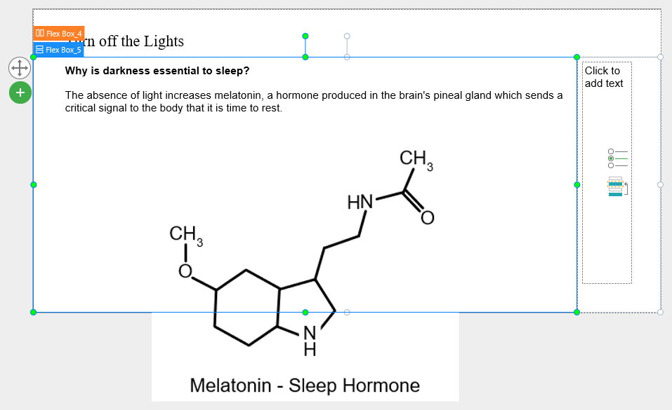

Going back to my example, I am going to customize the content and its flex containers in the Properties pane as follows:
- First, for the Flex Box_5 (flex container), I change the Width to 50%, Grow to 0.
- Then, for the text (content_1), I change the Grow to 0, Bottom Margin to 10.
- Then, for the image, I change the Lock Aspect Ratio to Height, Width to 53%.

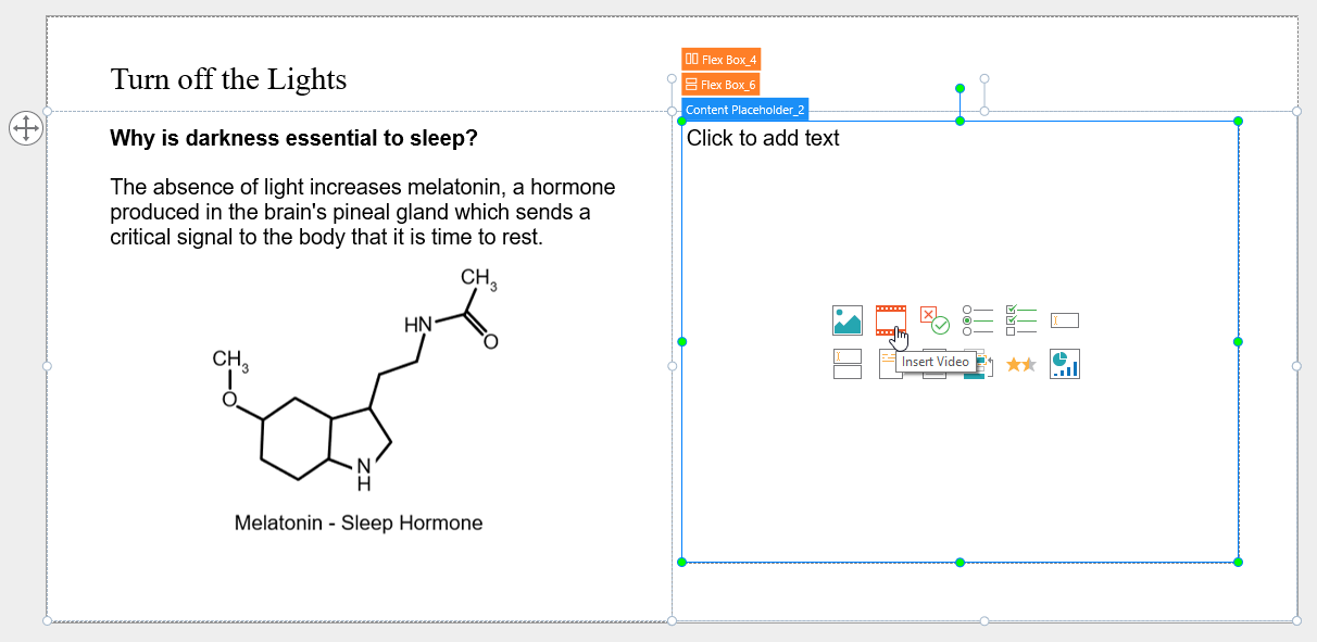

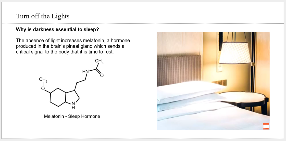

- I continue to add a video to the placeholder on the right by clicking the video icon and then selecting From File…
The video size is locked to width by default, so I will change the Lock Aspect Ratio to Height, and Width to 80%.
The placeholder (Flex Box_6) is a child of Flex Box_4 and it is vertically aligned to the top by default. I want to align the image to the center of the placeholder so I will change its Vertical Align to Middle.

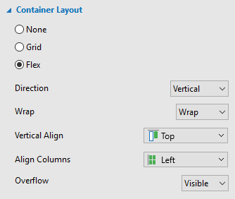

Properties of Flex Container Layout.
Direction
Flex layout will keep objects displaying along a row (in the horizontal direction) or a column (in the vertical direction). Select the direction (either Horizontal or Vertical) that you want to align objects.
Wrap
Select No Wrap or Wrap to specify whether objects should be in one line or wrapped onto multiple lines.
Note that the wrapping behavior only happens when items in a flex box are too large to display all in one line. In this case, when you select Wrap, they will be wrapped onto another line.

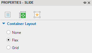

Use Flex Box as a Slide Container Layout
By default, the container layout of a slide in a normal project is None. However, it is Flex in a responsive project. In the normal project, you can change the layout container for a slide to Flex. To do that, in the Properties pane of a slide, Size & Properties tab, select Container Layout, then click Flex.
In this slide container layout, you’d better create the layout that you want right from the beginning before adding any object to it. The Preset Slide Layouts option is all you need. To access it, in the Home tab or the Insert tab, click Container, and then click Preset Slide Layouts. After that, you can easily add, arrange and customize objects inside it.
