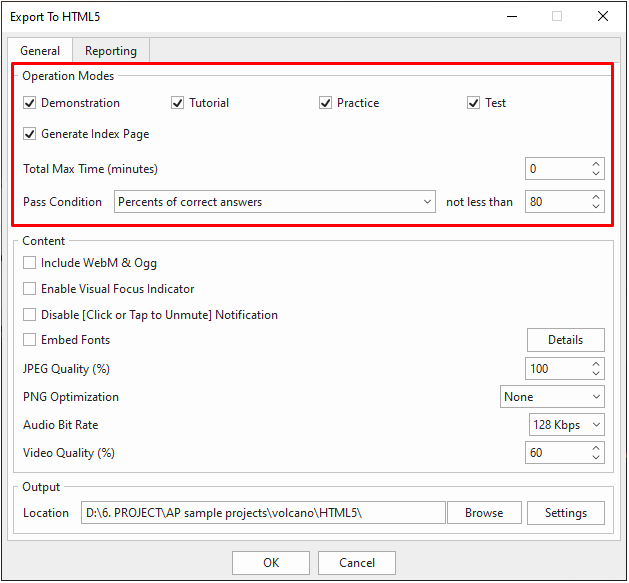

Step 1: In the Export tab > HTML5. This opens the Export To HTML5 dialog.
Step 2: Look at the Operation Modes section in the General tab, and select any modes you wish. Then, customize options like Total Max Time and Pass Condition. Note that the Total Max Time option is only available for the Test mode. For more information, see Export Projects to HTML5.
- When exporting a project to video, the video output is automatically in the Demonstration mode.
- By default, all four operation modes are selected. But you can select only the modes you want.
