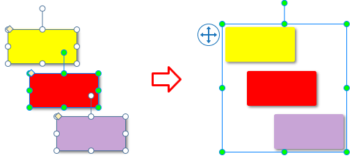

Object grouping lets you move, rotate, or resize multiple objects at the same time as if they were a single one. For example, you want to move several objects without changing their relative distance to each other. To do that, you have to select all of them, then drag the mouse, and do the same things each time you want to move them. Now with object grouping, things get much easier. Just group all the objects you want, select the group, and move it.
Do the following to group multiple objects:

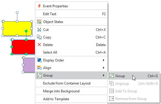

Step 1: Hold down CTRL while selecting all the objects that you want to include in a group.
Step 2: Right-click the objects > Group > Group . Alternatively, click the Format tab > Group > Group or the Home tab > Arrange > Group.
As a result, all the selected objects are grouped. A single box with resizing handles appears around the entire group.

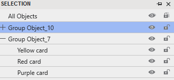

At the same time, in the Timeline pane, all the child objects’ time bars are merged into the only time bar of the group. The Selection pane lists all the child objects under and at the next indent level compared to their group. Click the +/- button to expand or collapse these child objects. If the Selection pane is not present, click the View tab > Selection to open it.
Step 3: Rename the group to easily find and work with it. Click the Properties pane > Interactivity > General or go to the Selection pane.

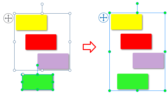

Add Objects to Group
ActivePresenter lets you add objects to an existing group. Do the following:
Step 1: Select a group and one or more objects that you want to add to the group.
Step 2: Right-click them > Group > Add to Group . Alternatively, click the Format tab > Group > Add to Group or the Home tab > Arrange > Add to Group.

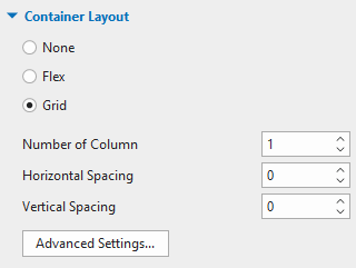

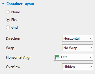

ActivePresenter supports flex layout and grid layout for a group. To change the group layout, just select that group, then go to the Properties pane > Size & Properties > Container Layout > select None, Flex, or Grid layout.
- None: You can freely change child objects’ size or move them to any position you want.

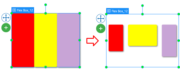

- Flex: The flex layout helps align child objects in that group either horizontally or vertically and distribute space between them effectively.
To be more precise, Flex layout allows aligning and distributing space within a container by expanding objects to fill the available space (growing) or shrinking them to prevent overflowing.
Each child object in flex layout is called a flex child. You can change its size, growing, shrinking, alignment, margin, and rotation in the Properties pane.
See Work with Flex Box for more details.

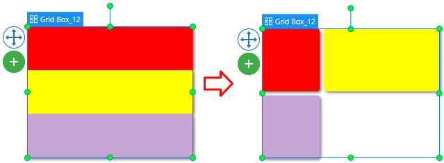

- Grid: The grid layout places child objects of a group in a grid pattern and align them both horizontally and vertically, which is useful when you want to draw tables to display fields in a grid layout.
Child objects in flex layout can have different sizes within a single row or single column but their sizes are predefined in the grid layout. The grid layout ignores the original size of all objects in a group. Instead, it assigns a fixed size to all of them.
The grid size is defined by the number of columns, horizontal spacing between columns, and vertical spacing between rows. Change the values for these parameters if needed. The number of rows will be automatically counted based on the number of child objects and columns.
See Work with Grid Box for more information.
