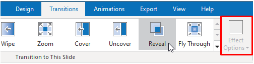

- Not all the transition effects in the gallery have further options like Cut, Fade, and Reveal. Therefore, you will see the Effect Options button appearing dimmed when selecting one of these three transition effects.
- Effect Options vary from effect to effect. For example, while the Zoom effect includes In and Out options, the Push effect includes 4 options which are From Bottom, From Left, From Right, and From Top.

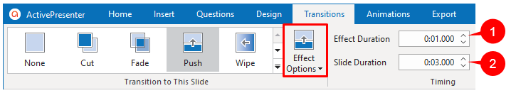

Step 4 (Optional): Change the slide effect duration by performing either of the following:
- Enter a value in the Effect Duration spin box (1) or click the up/down button to increase/decrease value.

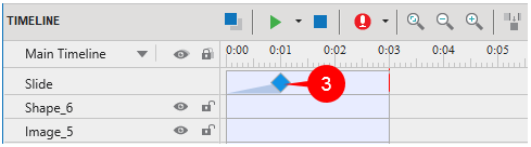

- Drag the blue diamond (3) on the slide bar in the Timeline pane:
The light blue area stretching from the starting point of the slide to the blue diamond indicates the duration of the effect. The longer it is, the slower the effect happens and vice versa.
Change Slide Duration
Normally, a slide will automatically extend its duration to contain objects inside it if the object duration is greater than the slide duration. However, you can change the slide duration if you want by doing any of the following:
- Drag the end edge of the slide bar in the Timeline pane to the left or right.
- Enter a value in the Slide Duration box (2).

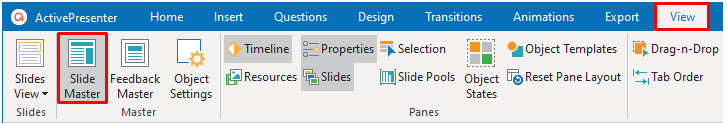

Add Transition to Slide Master
When you want all your slides to have the same transition effects, you can make those changes in one place – the Slide Master. Perform the following steps:
Step 1: Open Slide Master view. In the View tab, click Slide Master.
Step 2: Select the master slide that you want to apply transition effects. Then, take step 2 and step 3 mentioned in the previous part. When you edit the master layout, all slides that are based on that master will contain those changes. To know more about Slide Master, refer to the Using Slide Masters tutorial.

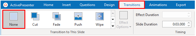

If you don’t want to use effects for slides, do either of the following ways:
- Select a slide, or hold CTRL while clicking if you want to select multiple slides. Then, select None in the Transitions tab.
- Simply drag the blue diamond downward out of the slide bar until the effect bar turns to grey. Then, release the mouse.
