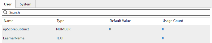

Step 1: In the Home tab, click Variables to open the Variables dialog.
Step 2: In the User tab of the dialog, you first need to click Add in the bottom toolbar. Then, specify a name, type, initial value, and description (if any) in the pop-up dialog.
- Name: Specify a unique name for the variable. The name should be descriptive, intuitive, and associated with the data stored. For example, use a learnerName variable to store learners’ names.
- Type: Represent what kind of data is stored with the variable, namely true/false, text, and number.
- Value: Specify the initial value for the variable. If you don’t assign initial values, the default values for true/false, text, and number variables are true, empty string, and zero (0), respectively.
- Description: Optionally, provide a description for the variable to state its use or purpose.
Step 3: Click Add&Close to save the new variable and close the pop-up dialog. Otherwise, click Add&Continue to save the new variable and continue creating other variables.

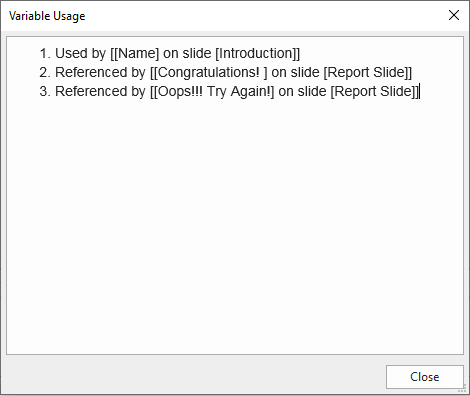

It’s easy to find where you use a variable by using the Usage Count column in the Variables dialog.
Double-click the hyperlinked number for the variable you want to find. Each time it is referenced by slide text or involved in the action will be counted.

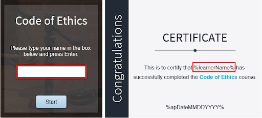

While variables store data, references retrieve and display the data anywhere in your eLearning course. For example, you can use a variable to get the learner name, then use the name throughout the course to personalize your training.
To do so, on the welcome slide, just ask learners to type their names in a field (text box) and store the learner’s input in a variable. Then, add references to that variable to display the learner name in multiple slides in your course. You can add references to any text caption, shape, button, or other text-based objects. Do the following:

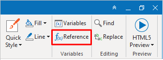

Step 1: Click the text area of the text-based object to open the inline text editor.
Step 2: Then, click the Home tab > Reference > select a variable. Both system and user variables are available to add references.
Step 3: Click OK to finish. Then, a reference appears in your text as a placeholder that contains the variable name getting enclosed within two percent signs (%). When you preview or publish the project to HTML5, the variable name will be replaced with the actual value of the variable it references.

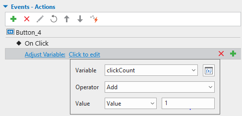

Now is the time for the Adjust Variable action. After you add this action to an event, click Click to edit to open a pop-up dialog letting you change the variable value.
Perform the following:
Step 1: Click the Variable combo box to choose a variable or click the Add Variable (+) button to create a new variable.
Step 2: Click the Operator combo box to choose an operator.
- True/false variables: assignment, toggle.
- Text variables: assignment.
- Number variables: assignment, add, subtract, multiply, divide.
Step 3: Specify the value by which the operation is to be done. It can be a specific value (you yourself specify it) or a value stored by another variable.
Then, the Adjust Variable action that counts the number of times users click a button will look something like this:

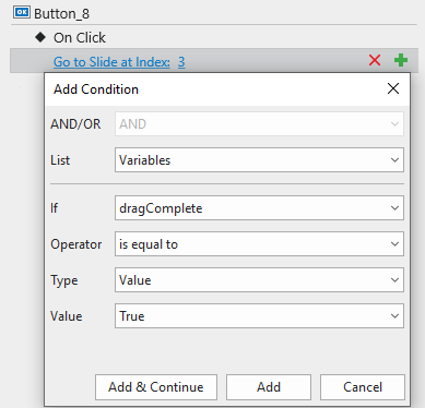

Create Conditional Actions
Variables are a good way to make conditional actions. For example, a true/false variable can help you set up conditional navigation for your eLearning course. Only when users finish a drag-n-drop exercise can they jump to another slide.
