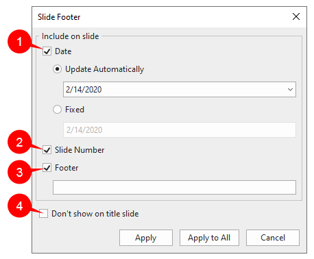

Step 2: Click the Insert tab, and then click Footer. After that, a Slide Footer dialog will appear like this.
Step 3: Work with options (1, 2, 3) in the Slide Footer dialog to insert footers. These options will be described later.
Step 4: (Optional) To hide the date, footer text, and slide number on the title slide, select Don’t show on title slide (4).
Step 5: Click Apply to save changes. If you wish to apply the changes to all slides in the current project, click Apply to All.

Insert Date into Slides
To make the date appear on slides, select Date (1). Then, you have the following two options:
- Update Automatically: Select it if you want the date to reflect the current date each time you open or print the project. You can choose the date format from the list.
- Fixed: Select it to set the date to a specific date. Do this by typing the date you want to the Fixed box. After that, the date remains the same no matter when or where you edit or deliver your presentation.
Insert Slide Numbers into Slides
To add slide numbers, select Slide Number (2). For the detailed procedure, see Add Slide Names and Numbers in ActivePresenter 8.
Insert Footer Text into Slides
Footer text is where to add a message, copyright, or anything you want to be visible on slides. To add a footer text, select Footer (3). Then, type your text in the Footer box.
