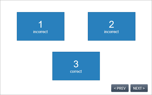

Let’s say a slide has three areas as below, of which two areas are incorrect (rectangle 1 and 2) and the last one is the correct area (rectangle 3). And, you want to track the number of incorrect clicks on rectangle 1 and 2 before a learner correctly clicks rectangle 3.
For that to happen, you can directly count the total clicks on rectangle 1 and 2, or place transparent shapes over these two rectangles and count the total clicks on these transparent shapes. This is necessary when all the areas you want to track belong to a picture, for example. You cannot count clicks on different areas of a single shape or picture!

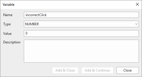

Step 1: Create a Number Variable
You only need one variable in this example to count the total incorrect clicks. Let’s name it incorrectClick.
1. Click the Home tab > Variables. Then, click the Add button at the bottom left of the dialog to start creating a new variable.
2. Specify the variable name, type, initial value, and description (if any). Then, click Add & Close to finish.

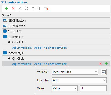

Step 2: Assign Actions to Adjust the Variable
In this step, you’ll add two actions to rectangle 1 and 2. Each action increases the incorrectClick variable by 1 each time a learner clicks the rectangle.
To do so, click the Properties pane > Interactivity > Events – Actions. Select each rectangle, then add the On Click event and the Adjust Variable action as below.
For details about events and actions, see Working with Events – Actions.
