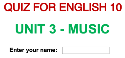

Insert a Text Entry
The first thing you need to do is inserting a text box where learners can enter their names. To do so, click the Insert tab > Text Entry.
A good practice is to include simple and clear instructions on how to enter the text.

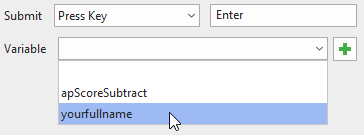

1. Select the text entry. Then, navigate to the Properties pane > Interactivity > Score & Reporting > Variable.

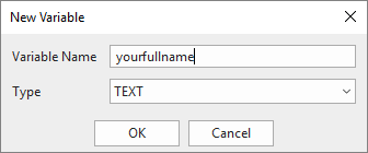

2. Click the Add Variable button to create an associated text variable.
3. Type the variable name in the dialog and press OK to finish.
You’ve done assigning a text variable to the text box. The variable will store text-based data from learners.
Tip: You can also click the Home tab > Variables to create variables. For details, see How to Add Variables in eLearning. If you already created a text variable and now want to associate it with text entry, in the Properties pane, click the variable list and select the text variable you want.

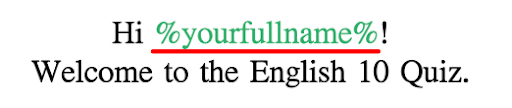

1. Click the text area of the caption to open the inline text editor.
2. Click the Home tab > Reference. Then, select the yourfullname variable from the dialog and click OK to finish.

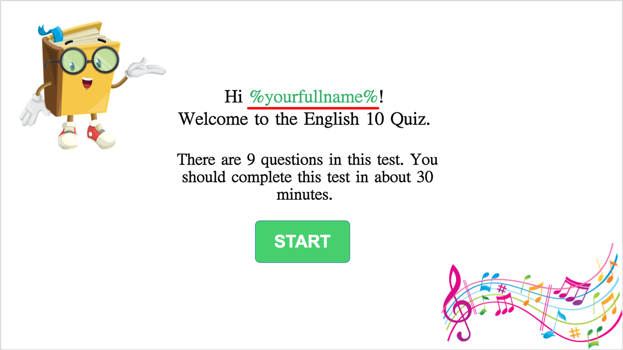

The variable reference appears in your text as a placeholder that contains the variable name getting enclosed within two percent signs (%). When you preview or publish your project to HTML5, ActivePresenter replaces the variable names with the actual values of the variables they reference.
Tip: If you remember exactly a variable name, you can type the name and put it between the % signs to reference that variable.

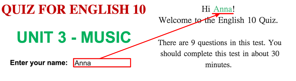

At this point, try clicking the HTML5 Preview button (in the Export tab) to preview your course. Type a name in the text box and click Start. Then, you will see that name appear in the next slide and other places it’s referenced.
