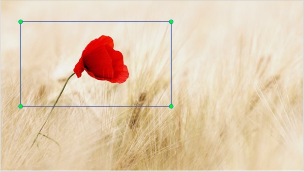

Step 1: Insert a zoom-n-pan object by clicking Zoom-n-Pan in the Insert tab.
Then, you will see the zoom-n-pan rectangle appear on the Canvas with four green handles.

- Hover the mouse over the outline of the zoom rectangle and drag it to the position you want.

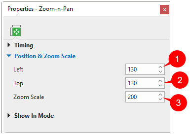

- In the Position & Zoom Scale section on the Properties pane, change the values in the Left (1) and Top spin box (2). This way provides more precise positions of the zoom effect on the slide, in which:
- Left: X position of the zoom rectangle from the left side.
- Top: Y position of the zoom rectangle from the top side.
Step 3: Change the zoom scale by doing one of the following:
- Hover the mouse over one of the four green handles until the mouse turns into a double-headed arrow, then drag the handle.
- In the Position & Zoom Scale section on the Properties pane, enter a value in the Zoom Scale spin box (3). Also, this way provides a more precise zoom scale.

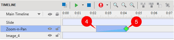

The zoom effect will start to zoom in at the starting point of the object (4) and end at the green diamond (5). The light blue area inside the object Time Bar indicates the effect timing.
To change the start time of the zoom effect, do one of the following:
- Click the zoom effect object Time Bar in the Timeline pane, then the mouse turns to a four-way arrow, drag it to the left or right. Besides, you can drag the starting point (4) to change the effect start time. However, using this way will change the effect duration at the same time.

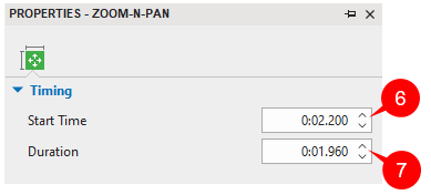

- In the Timing section of the Properties pane, enter a value in the Start Time spin box (6).

- Drag the green diamond to the left or right to decrease or increase the duration, respectively.
- In the Timing section of the Properties pane, enter a value in the Duration spin box (7).
