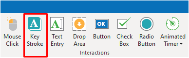

Insert Key Strokes
- Open the Insert tab > Key Stroke.
- Open the Home tab > Interactions > Key Stroke.

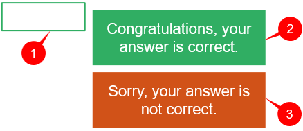

By default, a key stroke object includes three components:
- (1) the target area
- (2) a Correct Message
- (3) an Incorrect Message
When the interactive presentation is played, it will display nothing. It just waits for users to press shortcut keys, for example, CTRL+ALT+H. If the shortcut keys match the reference, the Correct Message (2) appears. Otherwise, the Incorrect Message (3) appears. For example, if the predefined value is CTRL+ALT+H, but users only press CTRL+H without holding down the ALT key, the Incorrect Message will be shown to him to inform that he is doing incorrectly.

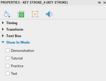

By default, the target area (1) is set to be invisible. You can see this default settings in the Properties pane > Size & Properties > Show In Mode:
To make the target area visible, select the modes (Demonstration, Tutorial, Practice, Test) that you want.

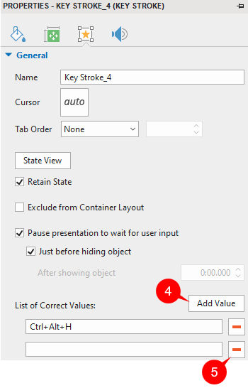

Step 1: Select the target area. In the Properties pane > Interactivity tab > General > List of Correct Values > Add Value (4).
Step 2: Click inside the blank box and press a key with or without modifier keys (CTRL, ALT, SHIFT) to set a correct value.
For example, press CTRL + ALT + H on the keyboard simultaneously, the system will display the correct value Ctrl + Alt + H in the blank box as in the above image.
Note that you can set more than one correct value by clicking on the Add Value button (4) as many times as you want.
If you want to delete a correct value, click on the (5) button to remove it.

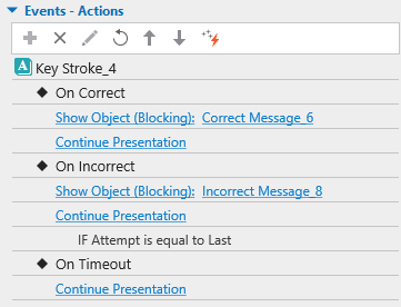

When you add a key stroke object to a slide, it has default events – actions as in the below image:

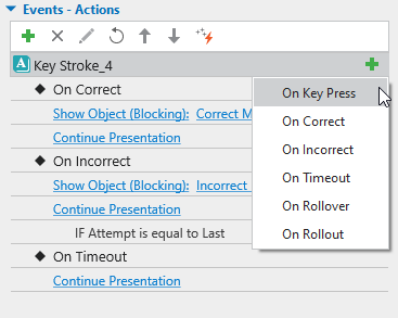

Except for those default events, you can add three additional ones, including: On Key Press, On Rollover, and On Rollout:
- On Key Press: Occur when users complete pressing shortcut keys.
- On Correct: Occur when users press shortcut keys correctly.
- On Incorrect: Occur when users press shortcut keys incorrectly.
- On Timeout: Occur when users don’t respond within the specified time.
- On Rollover: Occur when the mouse rolls over the target area.
- On Rollout: Occur when the mouse rolls out of the target area.
