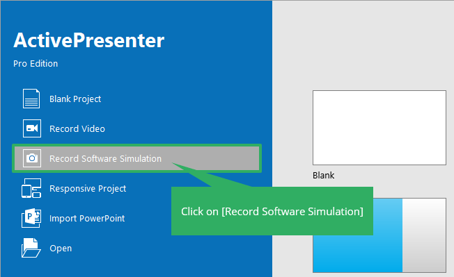

When you record software simulations, ActivePresenter automatically inserts mouse clicks wherever and whenever you make a click.

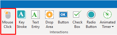

Insert Mouse Clicks
- Open the Insert tab > Mouse Click.
- Open the Home tab > Interactions > Mouse Click.

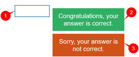

By default, a mouse click object includes three components, including:
- (1) the target area
- (2) a Correct Message
- (3) an Incorrect Message
When the interactive presentation is played, it will display only the target area (1) and wait for users to click anywhere on the slide. If users click on the target area, the Correct Message (2) will be shown. Otherwise, if users click outside the target area, the Incorrect Message (3) will appear.

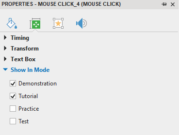

Note that, by default, the target area (1) is set to be shown in Demonstration and Tutorial modes only. You can see this default settings in the Properties pane > Size & Properties > Show In Mode:

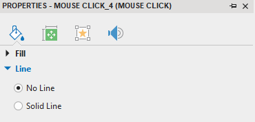

It’s possible to make the target area (1) invisible so that users cannot see the correct click area. To do that, select the target area, then, in the Properties pane > Style & Effects tab > Line > No Line.
Alternatively, in the Properties pane > Size & Properties > Show In Mode > deselect the mode that you want the target area to be invisible.

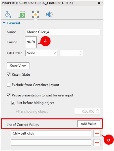

Set Correct Values for Mouse Clicks
As mentioned before, a mouse click object has two default feedback messages: Correct (2) and Incorrect (3). You need to help the system understand which are correct actions and which are not by setting the correct values.
There are three types of correct values for a mouse click object, including left-click, right-click, and left double-click (with or without modifier keys like SHIFT, CTRL, or ALT).
To set correct values, do as follows:
Step 1: Select the target area. In the Properties pane > Interactivity tab > General > List of Correct Values > Add Value.
Step 2: Place the cursor over the blank box and click the mouse button (left, right) with or without modifier keys to set a correct value.
For example, press CTRL on the keyboard and click the left mouse button simultaneously, the system will display the correct value CTRL + Left click in the blank box as in the above image.
Note that you can set more than one correct value by clicking on the Add Value button as many times as you want.
If you want to delete a correct value, click on the (5) button to remove it.
Besides, to help users identify a clickable area on the screen, change the image of the cursor when users hover the mouse over the target area. To do that, click on the (4) button and select a hand cursor image from the list:

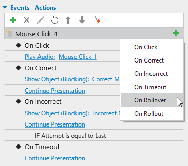

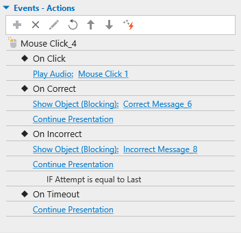

Add Events – Actions
When you add a mouse click object to a slide, it has default events – actions as in the below image:
Except for those default events, you can add two additional ones, including: On Rollover and On Rollout:
- On Click: Occur when users click on the target area.
- On Correct: Occur when users click on the target area.
- On Incorrect: Occur when users click outside of the target area.
- On Timeout: Occur when users don’t respond within the specified time.
- On Rollover: Occur when the mouse rolls over the target area.
- On Rollout: Occur when the mouse rolls out of the target area.
For more details, see Work with Events – Actions.
