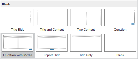

Slide layouts are built-in slides designed for your convenience. In ActivePresenter, there are 8 built-in slide layouts as you can see in the below image:

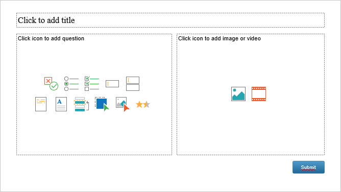

For example, the Question with Media is the default slide layout that you can use to add a question with the media like an image or a video. This layout contains three placeholders, including:
- Title placeholder at the top of the slide: You can click here to add a question title;
- A question placeholder on the left of the slide: It includes 11 buttons representing 11 types of questions in ActivePresenter. You can click one out of 11 buttons to add a question to this section;
- A media placeholder on the right of the slide: It consists of 2 buttons. Click one of these buttons to add an image or a video to this section.
Besides, this layout also has the Submit button on the bottom-left corner of the slide allowing learners to submit their answer.

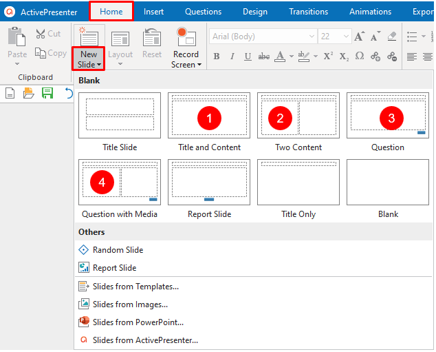

So, to insert questions from slide layouts in ActivePresenter, you can use 4 out of 8 built-in layouts, including:
- Title and Content (1): This layout includes a title placeholder and a content placeholder (to insert objects like question, image, video, report).
- Two Content (2): This layout includes a title placeholder and two content placeholders.

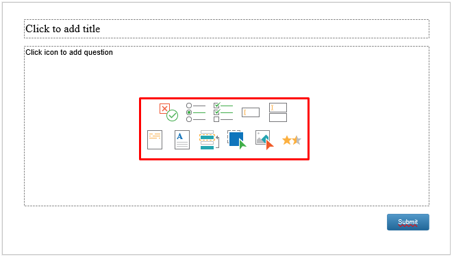

- Question (3): This layout includes a title placeholder, a question placeholder, and the Submit button.
- Question with Media (4): This layout includes a title placeholder, a question placeholder, a media placeholder, and the Submit button.

Step 1: Insert New Silde and Select its Layout
To insert a new slide, in the Home tab > click on the down arrow of the New Slide button > choose one out of 4 slide layouts mentioned in the previous part:
Alternatively, if you are working with the current slide and you want to change its layout, in the Home tab > click on the Layout button > select one out of four layouts from the list.
Or, you can right-click a slide in the Slide pane > select Layout > select one out of four layouts from the list.

After inserting a new slide and selecting its layout, click on one of the question buttons in the placeholder:
Then, a question will be inserted into that placeholder. After that, you can work with the inserted question as normal.
