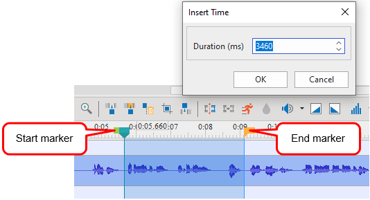

Step 3: In the Timeline pane > click the Insert Time button. This opens the Insert Time dialog.
Tip:
- You can use the default value in the Insert Time dialog (2000 ms) and change the duration later as shown in the next part of this article.
- You can also specify the freezing time by dragging the Start marker (in green) and End marker (in orange) of the Playhead along the timeline. Place the Playhead at the Start marker position and click Insert Time. Time will be inserted exactly between the two markers.
Step 4: Specify the duration of the control and click OK. After that, ActivePresenter will insert time at the Playhead position.

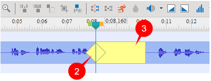

As you can see, a yellow diamond (2) and yellow bar (3) get superimposed on the time bar of the audio/video object. The yellow diamond specifies the points where the track pauses. Meanwhile, the yellow bar represents the freezing time you’ve inserted into the audio/video object.

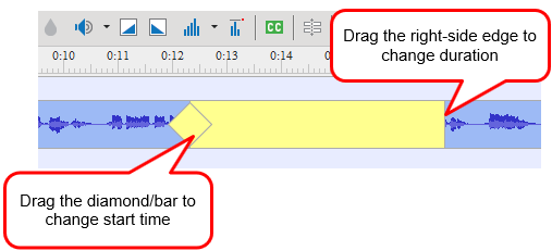

In general, the length of the yellow bar is adjusted to the duration you have defined in step 4. However, you can customize the start time and duration of the inserted time as you want:
- Drag the whole bar or the yellow diamond along the timeline to change the start time.
- Drag the right-side edge of the yellow bar to the right or left to increase or decrease the duration of the added time respectively.

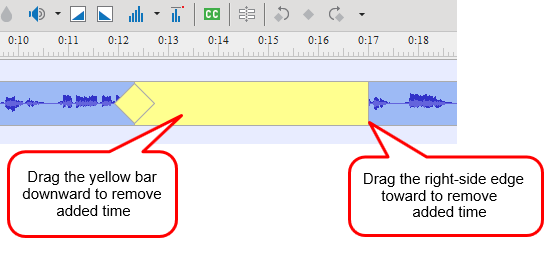

To remove added time from the host track, do either of the following ways:
- Drag the yellow bar (3) downward. Keep dragging until the bar turns gray and release the mouse button.
- Drag the right-side edge of the yellow bar toward the diamond till the yellow bar disappears.
As a result, the added time will disappear and the duration of the host track will be reduced. Obviously, the video/audio track will go back to its original properties.
