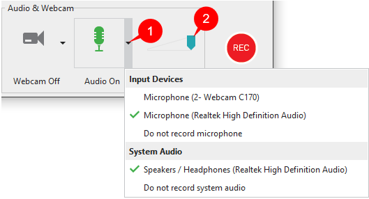

Step 1: To enable the audio recording function, click the Audio button to turn it green.
Step 2: Click the drop-down arrow next to the Audio button (1) on the Record Video Project dialog.
Step 3: Select one from input devices detected to record microphone audio in the Input Devices section.
The volume of the audio can be changed easily by dragging the Volume scale (2) or using the Adjust Volume tool on your computer.
Note: When you select to record system audio, all of the sounds on your computer including app notifications will be recorded. So, you should turn off notification sounds of unused apps to avoid any unwanted sound.
If you don’t want to record any of the microphone audio or system audio, just select Do not record microphone or Do not record system audio, respectively or both.

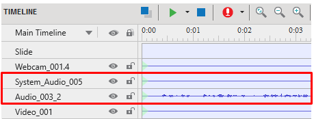

When finishing the recording, there should be separated audible audio objects in the Timeline pane like the image below.
Edit audio after recording
If you no longer need any audio object, simply select it and press DELETE on your keyboard. Otherwise, you are free to edit them such as cut, delete range, change volume, or even reduce noise as the same as normal audio objects.
