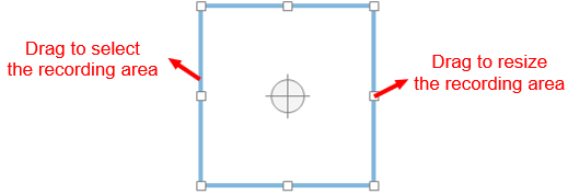

- A blue rectangle and a cross-hair (in the middle of it) which indicate the recording area. ActivePresenter 8 will record actions that happen only inside this area. The rest of the screen doesn’t appear in your recorded video.

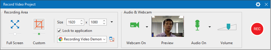

- A Record Video Project dialog. There are many things which can be done from here. For example, specify the recording area or open the Settings menu.

ActivePresenter gives you two ways to specify the recording area. One is using the blue rectangle to do that manually. But if you want to have more options, just work with the Recording Area section in the Record Video Project dialog.
In the Record Video Project dialog, the Recording Area section is a useful feature. The name says it all. That is, this section offers two capture modes: Full Screen and Custom. Choose one of them to specify the capture area.

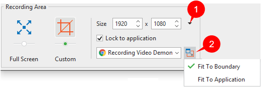

The Custom mode gives you the ability to record a partial screen. This mode also comes with which will please you, for sure.
- Enter the width and height value in the Size spin boxes. Or, click the Preset Sizes drop-down list (1) to select a preset from the list.
- Select Lock to application check box to fit the blue rectangle to the size of a specific application window. Then, no matter how you move or resize the target window, the recording area will follow. Thanks to that, users don’t need to manually resize it.
- Click the Change Lock Mode button (2) to show two other options. The Fit To Boundary command resizes the application window to fit into the blue rectangle. On the contrary, the Fit To Application option resizes the blue rectangle to fit into the application window.

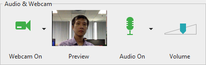

To set the webcam and audio, take a look at the Audio & Webcam section in the Record Video Project dialog. As you notice, the section has two commands. One is for recording webcam, and the other is for recording audio. You can select one of them or both.
- Webcam: Click the Webcam button to enable/disable the webcam recording. When the webcam is on, which allows you to have your face in the recorded video, the camera icon turns green. Then, a live preview of the camera appears next to the button. You can click the drop-down arrow next to the button to choose a detected webcam device from the list. For more information, please check: How to Record Webcam.
- Audio: Click the Audio button to turn on/off this recording option. When the icon is green, that means the audio recording function has been enabled. When you click on the drop-down arrow next to the button, this feature comes with two commands to capture audio system and audio from microphone. In case of the latter, select one from the microphones detected to record. In addition, there is a volume scale next to the Audio command. Drag it to change the recording volume if you want. For more details, you can refer to: How to Record Audio from Microphone and System Audio.

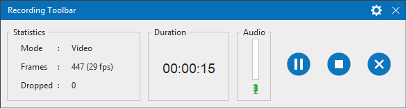

At the same time, an ActivePresenter icon is also shown in the system tray. Click this icon to show the Recording Toolbar allowing you to stop recording and view the recording status.
- Statistics section: Give you information about the recording. That is, Mode is the current recording project mode (Video for the Record Video function). Frames are the current frame number of the recording. Meanwhile, Dropped indicates the number of missed frames of the recorded video.
- Duration section: Show the current duration of the recording.
- Audio section: Show the audio sound level.
- Webcam section: Show the live preview of webcam.

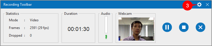

To hide any section as shown above, click the Settings button (3) to show the options. Then, unselect the section you don’t want to show.
Tip: When recording a partial screen, you can show the Recording Toolbar to view the statistic and easily pause or stop recording. Besides, it’s useful to display the webcam to get a live preview of yourself. Also, make sure you place this toolbar outside the blue rectangle or it will appear in the recorded video.
