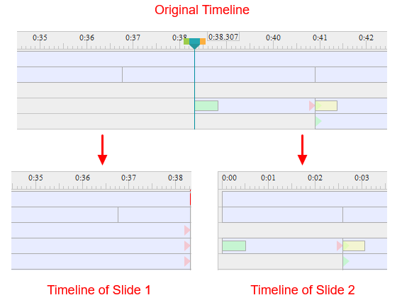

Then, the app automatically splits your slide into two slides. The left side of the Playhead remains its position in the original slide. Meanwhile, all objects and effects on the right side are moved to the new slide right under the original one. After that, you can treat the new slide as an independent one. In other words, just work with this slide as normally you do.
- If the Playhead lies in the middle of an object Time Bar, the Time Bar will be split at the Playhead position, and its right part is transferred to the new slide.
- The app will split any object at the position where the Playhead is placed no matter where you choose their object Time Bars.
- Use this feature to split a slide as many times as you want.
