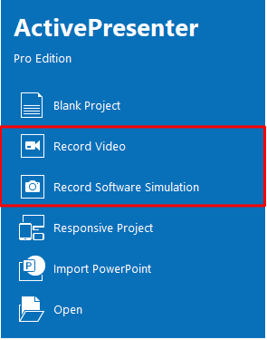

You now work with a very intuitive user interface in ActivePresenter 8. From the Start Page, you can choose between Record Video or Record Software Simulation to start recording in minutes.
The former is for recording a video demonstration as a video project. The latter is for creating a software simulation as a slide-based one.

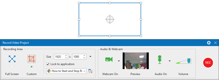

Step 1: Go to the Start Page > Record Video. Then, the blue rectangle and the Record Video Project dialog appear.
Step 2: Specify the recording area and other settings. For more details, see How to Record Video Demonstrations and How to Record Software Simulations.
Step 3: To start recording, click the Record button.
ActivePresenter will start to record after the countdown. Then, all of your actions happening inside the selected recording area will be recorded.

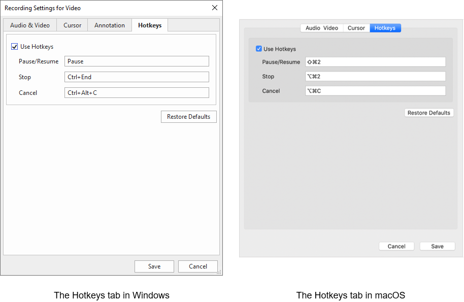

The easiest way to stop recording is by pressing CTRL and END (for Windows) or ⌥⌘2 (for macOS). However, you are able to change this keyboard hotkey to any of your choices. To do that, access the Recording Settings dialog by clicking the gear icon at the top-right corner of the Record Video Project dialog. Then you can see a Hotkeys tab here. This tab allows you to set the shortcuts for some of the most usually used commands such as Pause/Resume, Stop, and Cancel.
You can just click any command box and then press a key or a combination of keys to assign new hotkeys.
Note: Because of the differences between macOS and Windows keyboards, you need to use different hotkeys for performing these commands.

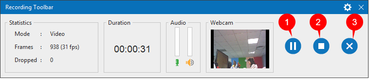

In addition, the commands above can be found in the Recording Toolbar dialog. When you start recording, the main dialog will be hidden. Instead, the ActivePresenter icon will appear on the Taskbar or system tray.
Then, click the ActivePresenter icon to show the Recording Toolbar dialog.
The Recording Toolbar gives you basic information about statistics, recording duration, sound level, and webcam preview. This toolbar also offers three functional commands: Pause, Stop and Discard.
- Pause (1): Come in handy when you’re busy with something and need to suspend the recording process for a while. Click Pause to temporarily pause the recording and click it again to resume.
- Stop (2): Click to stop recording. Click Stop to end the recording and step into the editing process.
- Discard (3): Click this button to display a dialog giving you three options. Discard is to abort the project that you are currently recording and remove all of what you’ve recorded. Otherwise, Re-capture is to abort the current recording without saving it and start a new recording with previous settings. Continue is to resume the current recording.
Tip: Showing the Recording Toolbar dialog right from the start of recording is good when capturing a part of the screen, especially when recording webcam at once. In the latter case, you’re able to see a live preview of yourself. To do that, in the Record Video Project dialog, click the Settings button (the gear icon) > select Show Recording Toolbar. However, the app will record anything happening inside the recording area, you should place this toolbar outside the selected area.
