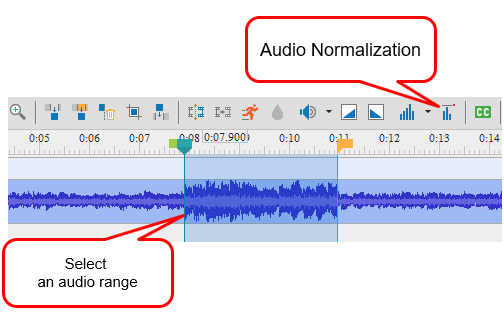

Step 1: Select the entire track or specify the audio range that you want to normalize.
Step 2: In the Timeline pane, click the Audio Normalization button
. Then, the Audio Normalization dialog will appear as the below image. Adjust the settings and click OK to normalize the selected track.
