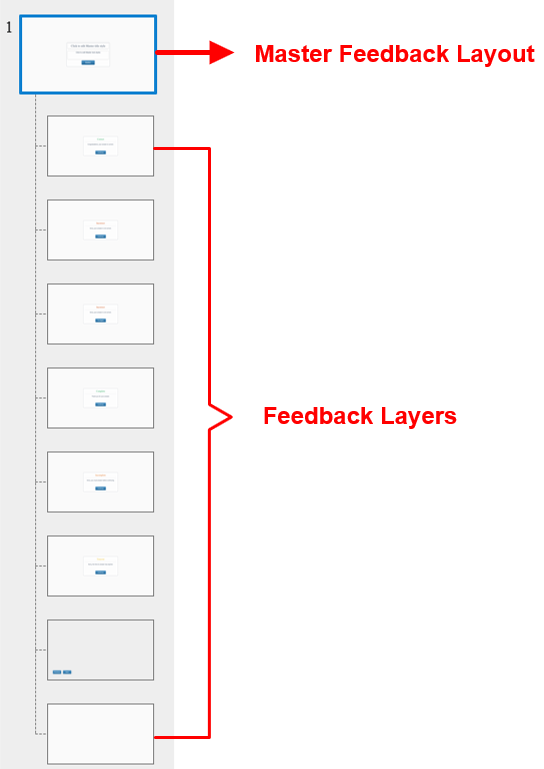

A feedback master includes 1 Master Feedback Layout and 8 built-in Feedback Layers like the below picture:
- Correct Feedback: Used in the On Correct event to let users know their answers are correct.
- Incorrect Feedback: Used in the On Incorrect event if the current attempt is the last attempt, letting users know their answer is not correct.
- Try Again Feedback: Used in On Incorrect event if the current attempt is not the last attempt. The message lets users know their answer is not correct and they can try again.
- Complete Feedback: Used in the On Complete event to let users know they have completed the answer.
- Incomplete Feedback: Used in the On Incomplete event. The message lets users know they have to complete answering the task before moving to the next one.
- Timeout Feedback: Used in Timeout event. The message appears to let users know the time to do the task is run out.
- Review Feedback: This feedback layer is used in the review mode. It is triggered in the OnLoad event of the slide. You have to use the apReviewMode variable to check if the presentation is in the review mode or not. There are two buttons (Previous and Next) in this layer. They let users navigate the presentation when reviewing a course.
- Blank Feedback: A blank feedback layer.

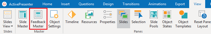

Initially, to open the Feedback Master View, access the View tab > Feedback Master

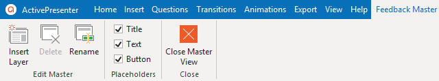

After customizing layers, click Close Master View
in the Feedback Master toolbar to close the master view. All the changes you made will be applied to the feedback layers.

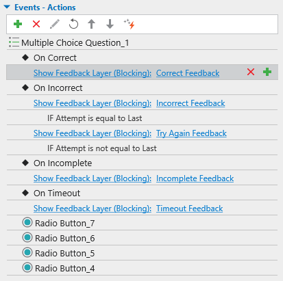

As you may know, in the previous version of ActivePresenter, the On Correct, On Incorrect, On Complete, On Incomplete, and On Timeout event shows its own corresponding feedback message. For example, when learners answer a question correctly, a correct message appears.
However, in ActivePresenter 8, those events have the default action which is Show Feedback Layer. For example, if the learners’ answer is correct, the default action Show Correct Feedback Layer of the On Correct event appears.
A Show Feedback Layer action has three options:
- Variable: Check this option to use variable to show feedback layer
- Hide After: Allows hiding the feedback layer automatically after a period of time.
- Blocking: Allows blocking the main timeline when the feedback layer is showing.

As mentioned above, ActivePresenter provides you with useful commands to modify the feedback layers.
With this tab, you can:
- Insert new layers. The newly inserted layers will have the same style as the master feedback layout.
- Delete or rename selected layers.
- Define which placeholders will be included in the selected layers (title, text, button).
- Close the master view.

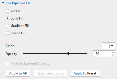

To change the background style, select the layout/ layers first. In the Properties pane > Style & Effects tab > Background Fill.

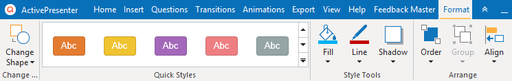

To design the button of the layout/ layers, select the button > Format tab > change the shape, styles, color, etc.

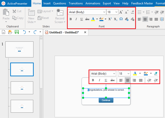

To change the text appearance, select the text. Then, you have two options. You can change the font, size, and color of the text in the Home tab or in the inline text editor.
