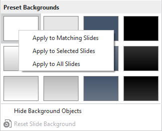

To have more options, right-click a style, and do either of the following:
- Apply to Matching Slides: This option works the same way as when you click a preset background style.
- Apply to Selected Slides: This applied the background style to currently selected slides only. The option is useful when you want to apply different styles to different slides.
- Apply to All Slides: This applied the background style to all slides in your working project.

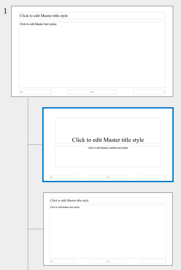

Step 2: In the View tab > Slide Master . Then, the Master View appears. Looking at the left pane, you see a selected layout used by the current slide.

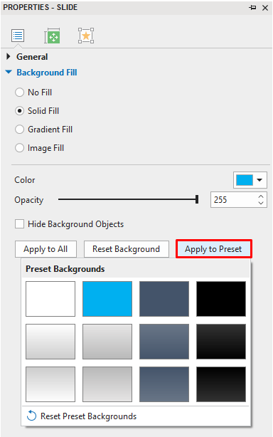

Step 3: Navigate to the Properties pane > Slide Properties tab > Background Fill section.
Here you have three options to customize the background style. So, select any of them:
- Solid Fill: Add a solid color background to your slide. To select the color, click the Color Picker (1).
- Gradient Fill: Specify a gradient as a slide background. A gradient is a mix of two or more colors which merge into each other.
- Image Fill: Import an image from your file system as a slide background. Alternatively, another way to do that is use the Background Image section in the Properties pane.
For further details about how to use those options, refer to Modifying Slide Background.
Step 4: Click Apply to Preset and select any preset background you wish to change. In this way, you can see the new color is applied to it immediately.
In case the changes don’t please you, click Reset Background to revert to the original background.
