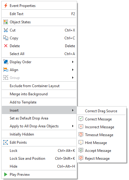

- Select an interaction object. Then, open the Questions tab > Messages > select one message from the list that appears:
- Right-click on an interaction object > Insert > select one message from the list:
By following one of the above ways, you can insert a new feedback message into a slide.

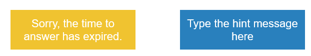

As you can see, the new message appears on a slide with the default text and format:
ActivePresenter allows you to change this initial appearance as you wish.
For example, to edit text, simply click the message and enter your new text. Or, you can right-click the message and select Edit Text (or press F2 on your keyboard).
Besides, to change the default format, open the Format tab or the Style & Effects tab of the Properties pane. Here, you can freely change color, line, shadow, etc. of the message.

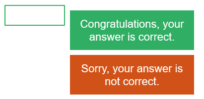

When you insert interaction objects like Mouse Click, Key Stroke, Text Entry, and Drop Area, these objects come with default feedback messages, including Correct Message and Incorrect Message:
These two feedback messages have the default settings for when to show it. That means these messages will be automatically shown when learners perform an action correctly or incorrectly.
