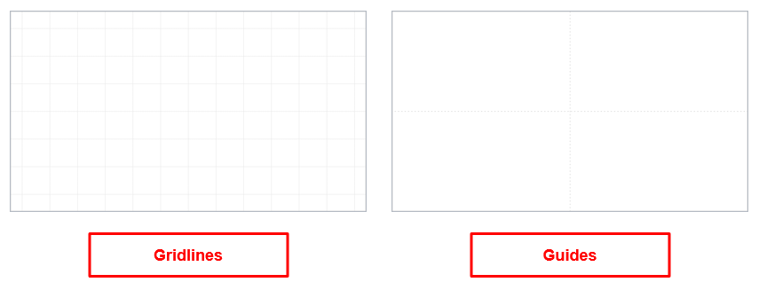

After that, dotted lines appear on the Canvas as gridlines as well as drawing guides. The guides appear as center horizontal and vertical lines of the Canvas and can float over objects. See the image below for more details:
