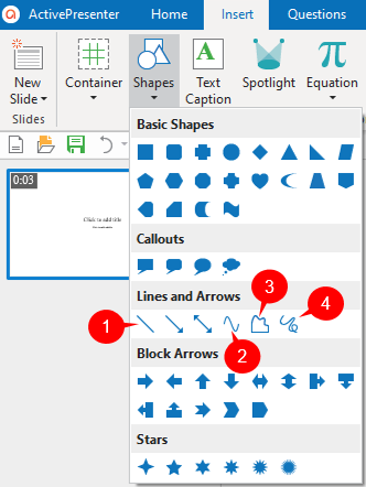

To explore line drawing tools, open the Home/Insert tab > Shape > Line and Arrows section.
There are 4 types of line drawing: Line (1), Curve (2), Freeform Shape (3), and Freeform Scribble (4). They let you draw straight lines, curves or freestyle.
- Line (1): Draw simple straight, point-to-point lines.
- Curve (2): Draw curved lines or shapes.
- Freeform Shape (3): Draw lines/shapes that include both straight and freeform segments (dual capability).
- Freeform Scribble (4): Draw lines/shapes as if you were using a pencil on paper.
