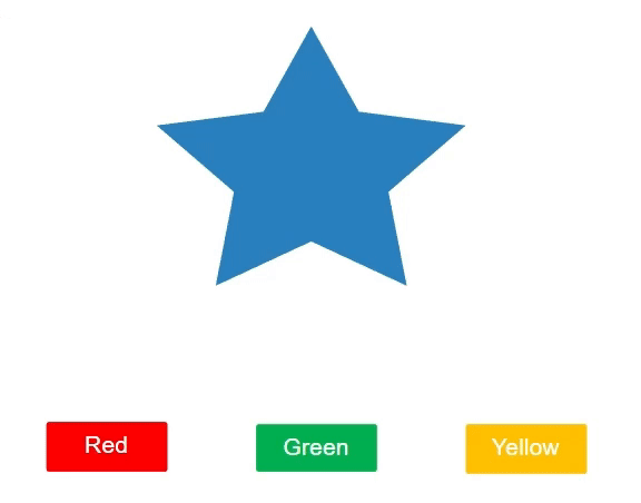

For example, you can run JavaScript to change the color of an object like this:
So, to add custom scripts with the Execute JavaScript action, do as follows:
1. Select one of the colored buttons.
2. Navigate to its Properties pane > Interactivity tab > Events – Actions section > Add the On Click event.
3. Assign the Execute JavaScript action to the On Click event. Then, click Click to edit. A dialog appears allowing you to write a script.

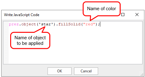

Write the script like the below image.
For your reference, here is the code:
prez.object('star').fillSolid("red");
Note: You must write the exact object name in the script as the name in its Properties pane > Interactivity tab > General section > Name. For the color name, you can replace it with the RGB color code.
4. Click OK to finish.

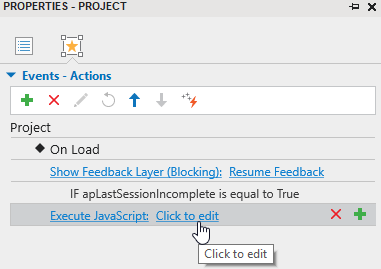

Step 1: Click the ActivePresenter button > Project > Properties.
Step 2: Navigate to the Properties pane > Interactivity tab > Events-Actions section > add the Execute JavaScript action to the On Load event of the project.

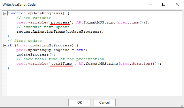

For instance, when you need to show the progress out of the total time of the project then execute the following custom JavaScript:
function updateProgress() {
// set variable
prez.variable('progress', AP.formatMSString(prez.time()));
// schedule next update
requestAnimationFrame(updateProgress);
// first update
if (!prez.updatingMyProgress) {
prez.updatingMyProgress = true;
updateProgress();
// show total time of the presentation
prez.variable('totalTime', AP.formatMSString(prez.duration()));
In which, “progress” and “totalTime” are text variables you need to create to reference them on Canvas.
