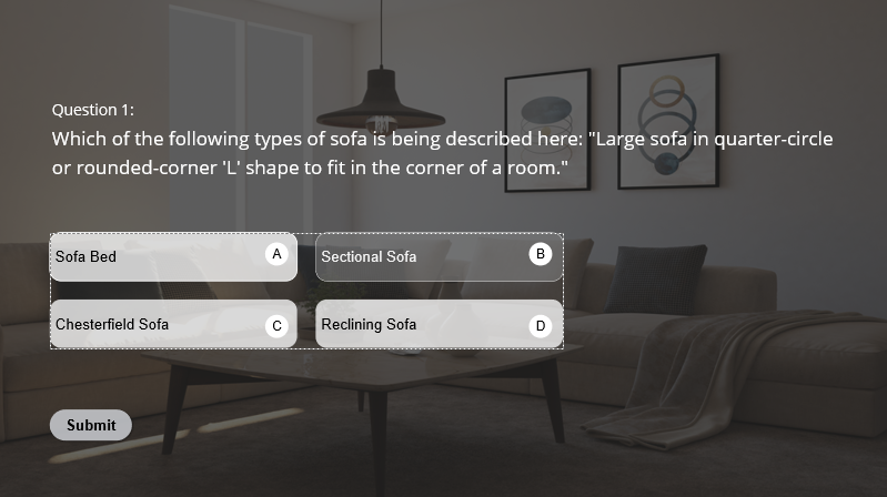

Then, a new Multiple Choice Question slide including the top text box (1), answer area(2), and submit button (3) is inserted into your project as in the image below:

1. Complement with Shapes, Images, Videos, or Audio
If you want to add a background image to this question, navigate to the Properties pane of the question slide, in the Background Image section, select the option to import the image like below:
Besides, you can freely add resources such as shapes, images, videos, audio tracks, and more to your question by accessing the Insert tab, or simply dragging and dropping them from your computer to Canvas.
Note: Don’t use too high-resolution images much larger than your slide size because this can cause slow loading.
