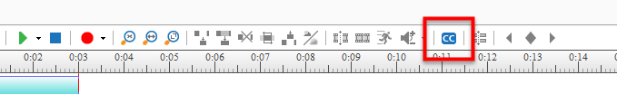

Step 2: Select Annotation tab (1). In the Annotation tab, click the Closed Caption button (2).
Or click the Insert Caption button on the Timeline which has the same function.
Then, you will see a yellow bar appears in Closed Caption line. Drag the yellow bar to adjust Start Time and Duration of the closed caption.

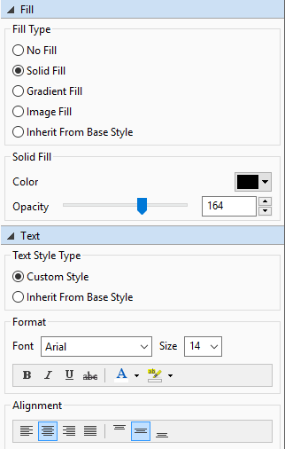

Step 3 – (Optional): Go to Closed Caption Properties pane to have further settings.
In this pane, you can change the Fill, Color and Opacity for the Closed Caption. You can also adjust the Text Type, Style and Size here.

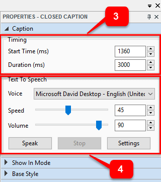

ActivePresenter also allows you to adjust Start Time and Duration of any Closed Caption from the Timing section (3). Text to Speech (4) is where you can convert all text into speech.
