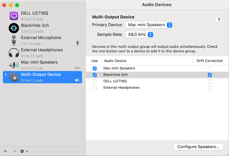

To record system audio while still hearing it, you can set up an Aggregate or Multi-Output Device in macOS:
- Open Audio MIDI Setup.
/Applications/Utilities/Audio MIDI Setup
2. Click + (bottom-left corner) and select Create Multi-Output Device.
3. Check BlackHole 2ch and Built-in Output (or your main output device).
4. Right-click Multi-Output Device and select Use This Device for Sound Output.

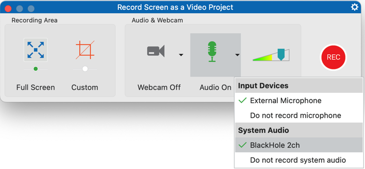

Step 3: Select BlackHole 2ch on ActivePresenter Audio Input Device
When setting up to record screen in ActivePresenter, you select BlackHole 2ch to record system audio.

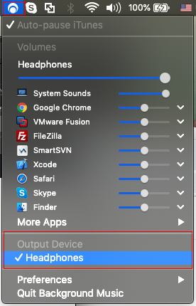

Record System Audio on macOS with the Background Music Software
This method applies for ActivePresenter 7.5 for macOS or later versions. The steps are quite simple:
- Download Background Music from our site, then double-click the downloaded file to install if you have not done it yet.
- Start Background Music by clicking Launchpad > Background Music. It also starts automatically right after installing. It is recommended to start any applications which play audio after starting Background Music.
- Click the Background Music icon on the top bar and make sure that the proper output device is selected so you can hear the system audio while recording it.
- Click the Speaker icon on the top bar and make sure the Background Music device is selected.

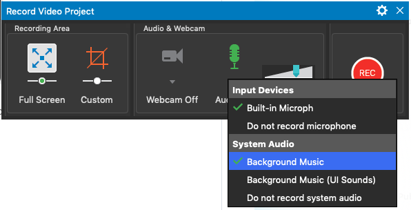

- Start ActivePrenseter and select Background Music in its audio device list.

- In the latest ActivePresenter version, select Background Music to record system audio
