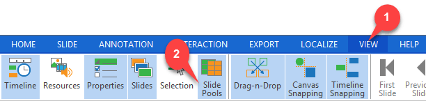

- Click the View button (1)
- Select Slide Pools (2)

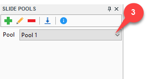

A Slide Pools window pops up with a default Pool. (3)

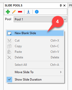

Add slides to Slide Pool
To add more slides into Slide Pool, you can do the same as inserting new slides in a project:
- Right-click the Slide Pool
- Select New Blank Slide from the pop-up dialog (4)

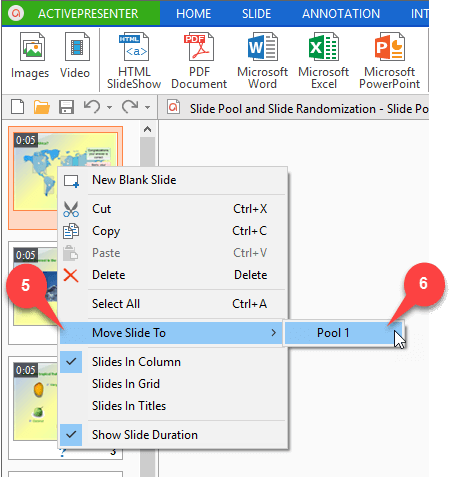

To move slides from Slide Pane to Slide Pool, take following steps:
- Right-click the slide in the Slide Pane
- Select Move Slide To from the list appears (5)
- Select the target Pool (6)

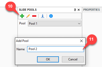

Add more Slide Pools
You can add multiple slide pools in a project. This is useful when you want to manage the slides in separate group, for example slides that contain different level of questions will be placed in different Slide Pools.
Take the following steps to do that:

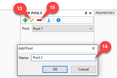

- Click the Add new pool button (10)
- Name the new Slide Pool in the Add Pool dialog (11)

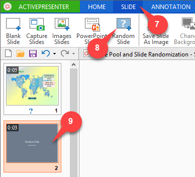

- Click the Slide tab (7)
- Select the Random Slide button (8)
The random slide with a dark background appears. (9)

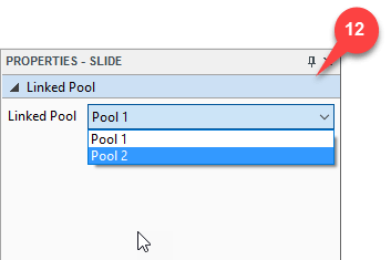

By default, the new Random Slide is linked with the first Slide Pool in the project. However you can link that random slide to any other Pool.
To do that, from the Properties Pane, in Linked Pool section, choose the Pool you want to link. (12)

Working with Slide Pools pane
Here you can change slide pool name, add more slide pool, view slide pool information, and so on. You can also Import slide pools from other project to reuse.
Change Slide Pool name
To change the name of the Slide Pool, take following steps:
- Click the Change pool name button (13)
- Type the new name in the Change Pool Name dialog (14)
Delete Slide Pools
To delete a Slide Pool, click the Delete this pool button (15)
When you delete a Slide Pool, all slides linked to the deleted Pool will be linked back to the first Pool in your project.
