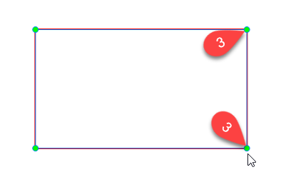

Then you will see the Zoom-n-Pan object appears in the Canvas, click and drag the green handles (3) to adjust the size of the zoom area, then drag it to the position you want.

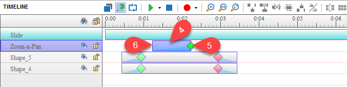

Step 3: Click and drag its object on the Timeline to change it Start Time. (4)
Step 4: Click and drag the green diamond (5) to adjust the effect duration.
ActivePresenter will start to zoom in at the starting point of the object (6) and end at the green diamond (5). You shouldn’t let the effect duration too short or too long because it might cause the zoom in and out to appear in hurry or disjoint.

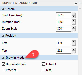

You can also change those attributes in the Properties Pane and select the mode in which the zoom effect will be shown in the Show in Mode section. (7)
